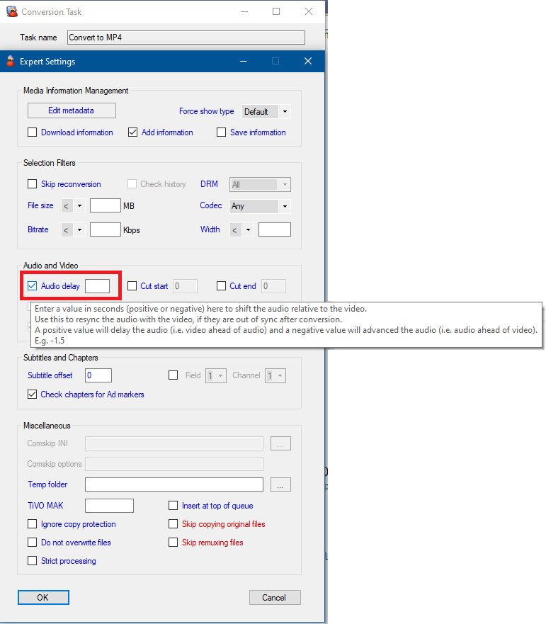

It’s actually not uncommon to see audio delays when converting files. They can happen for a variety of reasons.
MCEBuddy can detect these audio delays and compensate for them if required (by default it does not). Most of the time the delay information is stored in the converted video so the playback software should be able to correct for the delays at runtime. If that’s not happening with your player, you can ask MCEBuddy to auto correct for these delays by editing your profile.
See this: MCEBuddy - Advanced Settings, Commands and Tweaking
John, from your logs I see in your profile:
ffmpeg-audiodelay=skip
change this to
ffmpeg-audiodelay=auto
and it should automatically correct for the audio delays while converting. Note this only works for profiles based on ffmpeg, handbrake and mencoder encoders, it does not work on profiles using the copy encoder.
Alternatively, if you’re seeing a fixed amount of deviation in all videos, you could also correct for it from the Conversion task → Expert settings → Audio delay

I suspect the delays are being introduced by ffmpeg during the remuxing intermediary step which is primarily needed to improve compatibility with other programs. Given your setup you may not need that intermediary step.
Try checking the option to Skip remuxing in the conversion task → expert settings page and see if that resolves your issue.

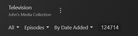

I literally have over 124,000 episodes with a majority of those episodes/videos having these (are they artificial?) audio delays - some which make them unplayable on Apple TV devices, and the remaining have delays in playing back the video on players such as VLC on other devices.
Currently, I am using MKV Unprocessed with the Metadata lookup set to prioritizing Season/Episode title and Overwriting Metedata Filenname ising TVDB for consistency and also to prevent shows that re-use episode titles from being incorrectly matched to the wrong season (I think MCEBuddy, always uses the earliest episodes S/E in the series…..
So, what would you suggest as the best/easiest method to remux these episodes without potentially screwing up the episode ordering?

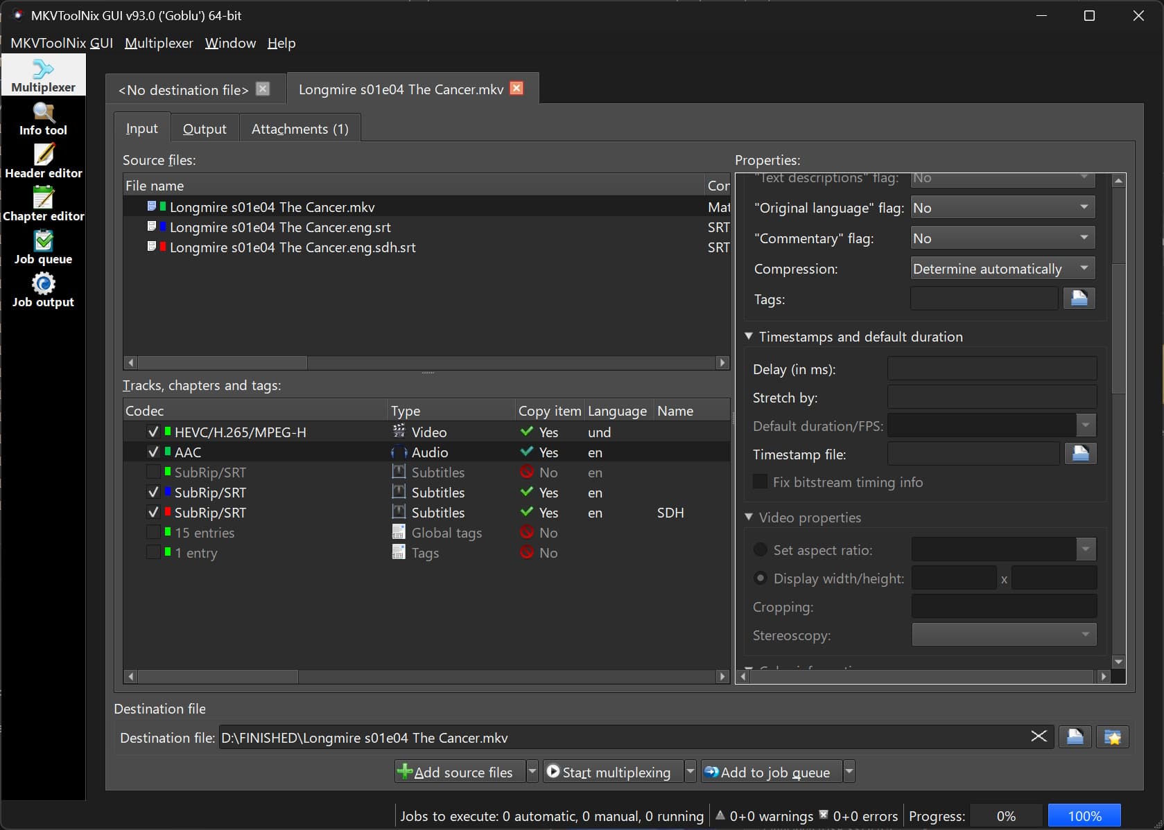

Taking some episodes (Longmire) that were processed through MCEBuddy in 2022 and running them through MCEBuddy again with the new build with Remux set default and Skip, still retains the prior files “delay relative to video”.
If I take that same file from 2022 and put it through MKVToolNix without any delay for the audio track, the output file shows no delay in MediaInfo and plays immediately in VLC with no delay in video starting.
Do you think that there is a way to “correct” and/or remove the delay using MCEBuddy?
