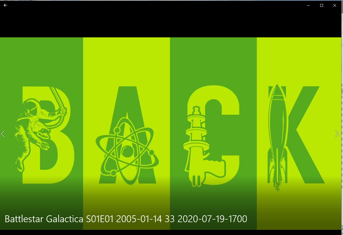

Short version of the story… I have recorded battlestar galactica through channels DVR using my spectrum logins. Its the national feed without regional commercials. Instead of commercials it has these filler screens . Comskip doesn’t seem to catch them. I have tweaked quite a few parameters. But nothing seems to catch it. During the splash screens there is no audible sound but the silence trigger doesn’t seem to work. I would appreciate any suggestions.
