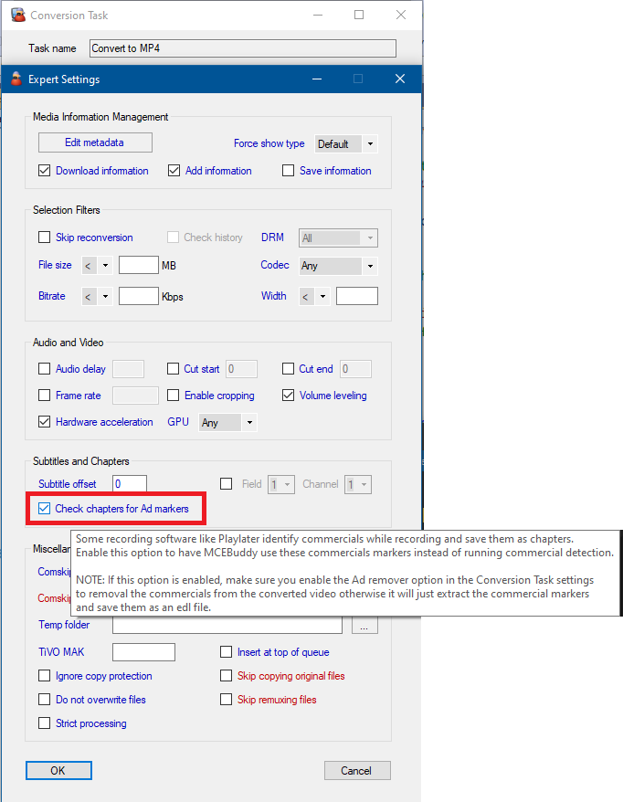

I had a look and it appears that your recodings have advertisements markers embedded into the mp4 file which MCEBuddy is using instead of running Comkip.
INFORMATION> 2025-08-21T23:08:22 MCEBuddy.Engine.ConversionJob → Checking for Advertisement Chapter Markers
→ PlaylaterAdMarkertoEDL: Cut segment Start:5957.512 Stop:6843.738
If you don’t want it to use the embedded chapter markers and use Comskip instead, turn off that option in the Conversion task → Expert settings → Subtitle and Chapters → Check chapters for Ad markers
