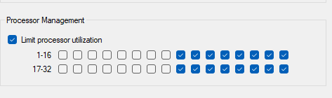

Does anyone know how to set processor affinity with AMD 5950x? I’m trying to set it so it can use just 8 cores, but I get this error in the logs.
2025-06-11T13:09:52 MCEBuddy.AppWrapper.Base → Setting CPU affinity to → -16711936
WARNING> 2025-06-11T13:09:52 MCEBuddy.AppWrapper.Base → Error trying process priority or setting CPU affinity to → -16711936
System.ComponentModel.Win32Exception (0x80004005): The parameter is incorrect
at System.Diagnostics.Process.set_ProcessorAffinity(IntPtr value)
at MCEBuddy.AppWrapper.Base.Run()
Assuming you have 16 cores? Can you attach the conversion log file.
Could you also take a screenshot of the CPU affinity setting page in MCEBuddy so we can see what core you are trying to use.
It has 16 cores and 32 threads. I’ve been playing around with different patterns and most show the error.

Try limiting it to only a combination of the first 16 (leave 17-32 unchecked) and see if the error goes away.
That appears to work.
2025-06-12T06:31:14 MCEBuddy.AppWrapper.Base → Setting CPU affinity to → 255
We’re trying to figure out what’s going on, if it’s an issue with the code or how logical processors are treated with the new AMD processors.
Could you try this, in your Processor Management page, select CPU’s 1 to 17 (all 16 on the first row and 1st from the second row). Then run a conversion and let me know what you see in the logs. Tx
