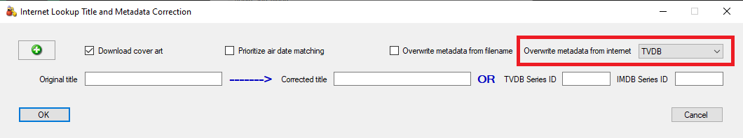

This looks quite useful, but I don’t often record movies - just tv shows mostly from PBS - which leads to the problem that maybe this could be modified to correct.
If I record a program such as “Unforgotten” a British TV program PBS insists on calling it “Unforgotten on Masterpiece” which when looked up in the TVDB doesn’t exist. How can this or similar script be used to strip off the ‘on Masterpiece’ and leave just the actual name of the program?
That’s doable using a simple replace or the the new regex feature we added for correcting metadata.
If all the names are identical and you just want to correct them the same way use the simple replacement and correction feature. Conversion task → Expert settings → Correction
If the title keeps varying slightly see this post for details on how to match and replace the title using regex.
If you aren’t familiar with regex use the AI bot on the top bar and you can ask it to create a regex to match your specific title variations and use the regex replace feature to extract the correct match.
