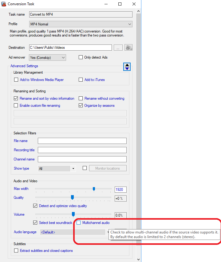

Yes it does, check the Multichannel audio box in the conversion task options page:
The default is stereo audio since not all devices support multi channel audio (including some apple devices)
Thanks for the reply. I have had the multi channel audio selected however I have not check the select the best audio box. Do both need to be selected? I will give that a try.
Yes putting check marks in those two boxes caused the mp4 to save the audio as 5.1 plus. Thank you.
