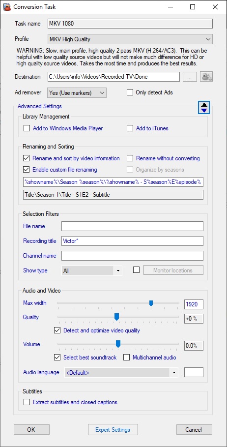

Ik heb een instelling in de Conversion Task veranderd → Ad Remover → Yes, Use Markers

Your conversion task settings are set to not commercial commercials.
Commercial Removal -> None

Hmmm, I have the Ad Remover set to Yes (Use Markers) so I’m not really sure what is turned off? This setting worked with cutting the “second cut” but not the first. When I had it set to Yes (Comskip) nothing was cut at all. Again, this is all using the Custom Cut feature
Something weird going on. The logs show it’s disabled which is why it’s not cutting. Try to uninstall and reinstall MCEBuddy and this time download the latest 2.4.10 beta. You may need to recreate your conversion task and see if that helps.

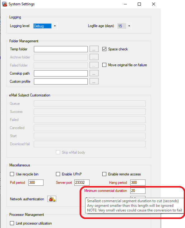

MCEBuddy won’t make cuts less than 20 seconds (by default, you can adjust this as show below). This is due to a limitation of the underlying encoders which can cause the process to fail if the cuts are too small (due to lack of I frames). So keeping that in mind, I see this in your logs which sounds about right to me:

Having said that, if you want you can reduce that 20 seconds down to 0 or any number you want from the System Settings page, YMMV. We set that number based on the recording samples we have from over 100+ countries and thousands of channels, but you can always customize it to what works for you. Just keep in mind that if the cuts start failing it may be because the segments are too small.
