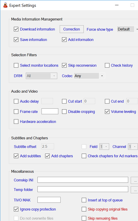

Every conversion task will be fed files from every monitor location unless in the Conversion Task → Expert Settings page you’ve “selected” specific monitor locations to link to that conversion task.

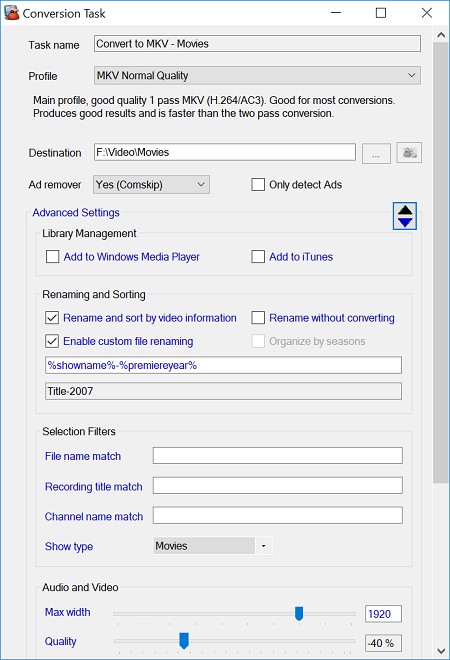

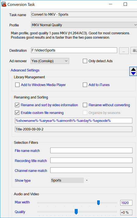

I use SD HDHR PVR also. You’ve over-complicated your setup.

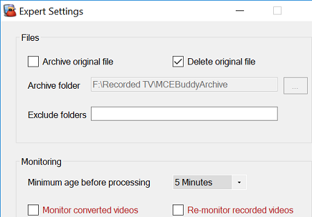

  • Set the monitor to the base HDHR directory. Set MCEBuddy to not touch any files until 5 minutes after last modification (to not try to convert live TV).
  • HDHR automatically puts the guide categories for Sports/Movie/Other. There is no “series” or “special” or “other” category.
  • The order of the processing rules is important.

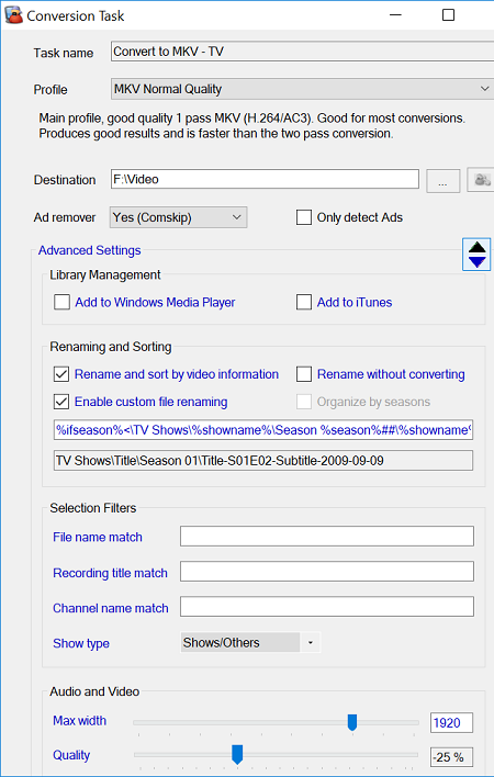

  • Process movies first. No matter where they record, MCEBuddy gets the category from the metadata in the file. Use a custom file rename - I like title.release-year.
  • Process Sports next. Same deal. Use a custom file rename - I like title.air-date.air-time.
  • Process Series/Specials LAST. Same deal, but you need a custom renaming here to test for a series, and use a custom series rename if true, and a custom specials name if not. You have to do this because there is no separate “series” category from “other”.
  • Use the custom filename to move everything to the right place. I move mine to where Plex looks for them.
Then you won’t need all of the exclusion stuff. I’ll help if there’s tweaks I’ve missed. Ask.

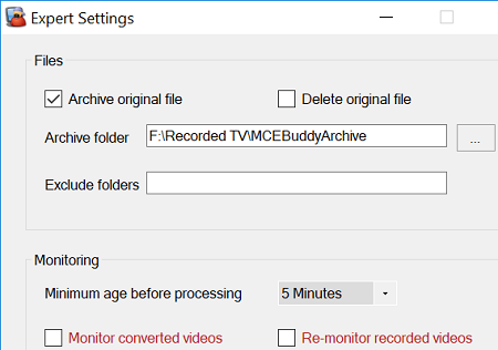

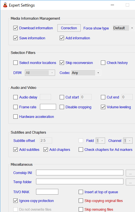

Check the Expert Settings Monitor locations, that’s one place to limit which locations runs with which task.
@Rboy - thanks for the reply. According to @mike808 with his config I don’t require exclusions in the monitor locations. I believe you have replied to me in the past in a previous thread about this same issue once before.

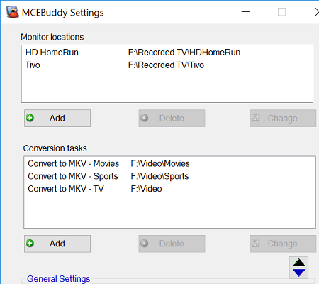

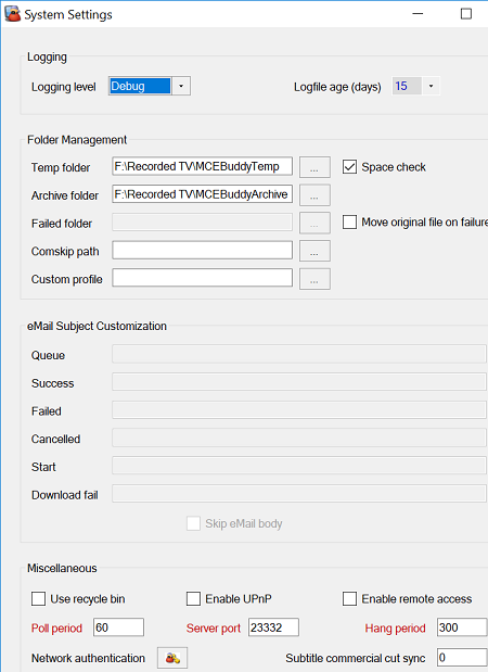

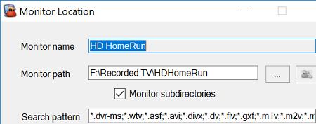

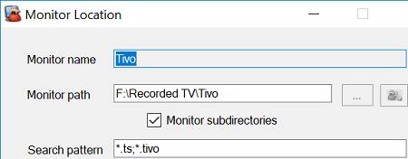

Here’s my folders:
driveF-Recorded%20TV%20directory
Here’s my settings:
MCEBuddy-conversion-2-sports-02
MCEBuddy-conversion-1-movies-02
MCEBuddy-conversion-3-shows-02
MCEBuddy-monitor-Tivo
MCEBuddy-monitor-hdhomerun
MCEBuddy-monitor-Tivo-expert
MCEBuddy-monitor-hdhomerun-expert
MCEBuddy-settings-01
MCEBuddy-settings-02
Hope this helps. Feel free to re-use the images in a how-to.
