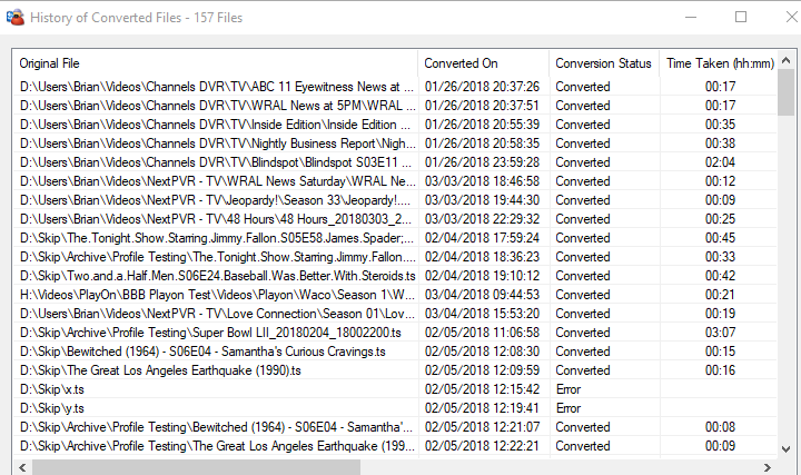

Wanneer ik op de kop van de kolom Converted On klik, sorteert MCEBuddy de kolom niet correct. Daten in maart staan na die in februari.
Dit is geen triviaal probleem, aangezien dit de gemakkelijkste manier is om de meest recente conversies bij te houden.
Schermafbeeldingen:
Dit is na een klik op Converted On:

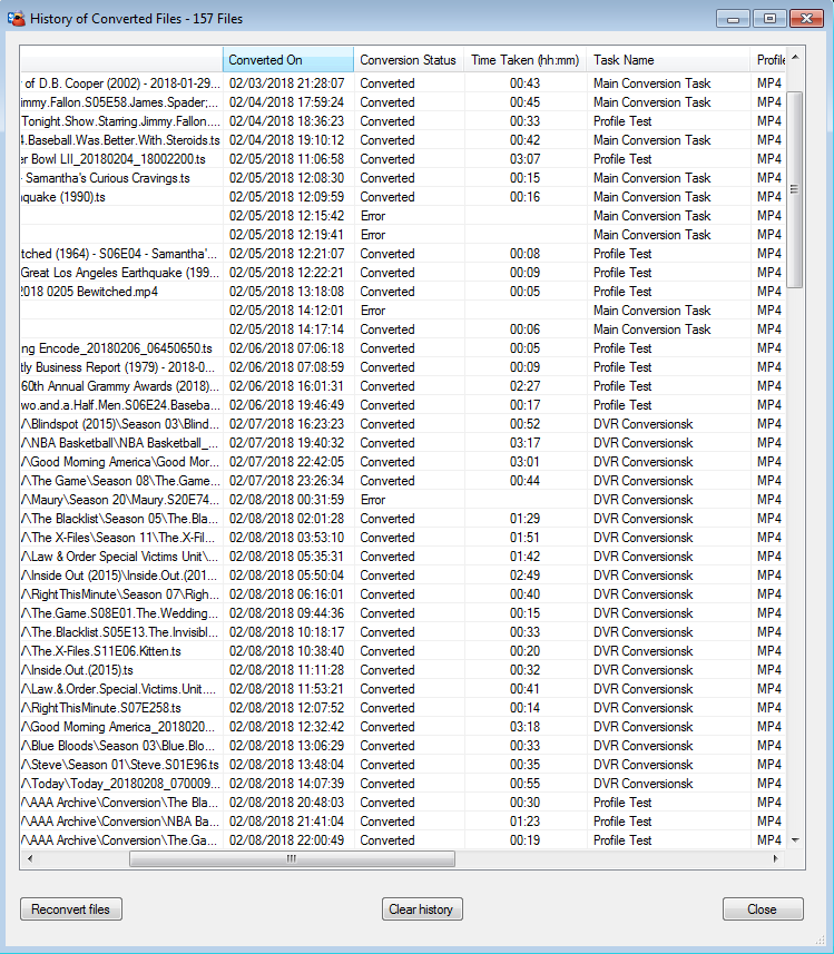

I cannot replicate the issue, it’s showing up sorted correctly here. Can you attach your history file so we can replicate the problem
Also what’s your system date/time format? (dd/mmy/yyyy or mm/dd/yyyy)?
Thanks for looking at this. I have posted my history file below.
Here are my formats … I use dd-mon-yy which might be less conventional.
history.zip (10.2 KB)
I’m unable to replicate the issue not matter what I try, it’s sorting it perfectly every time.
Can you try it on a different machine?
Now it’s getting stranger.
I installed on another machine, moved my history file, and I have reproduced the problem.
