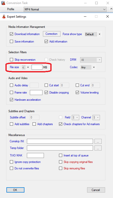

Lets say i would like to convert only media that greater 2000mb
I would think I put >2000
The “skip conversion” is confusing me !
Does that have anything to do with the file size?
The option is called “Skip reconversion”. You can rest your mouse on the option for more detailed help.
It basically checks if the file has already converted (it compares the filenames) and if it find that that file has already been converted then it wont’ convert it again. This helps preventing reconverting files with certain recorders like Media Center which re-record the same show with different source filenames.
