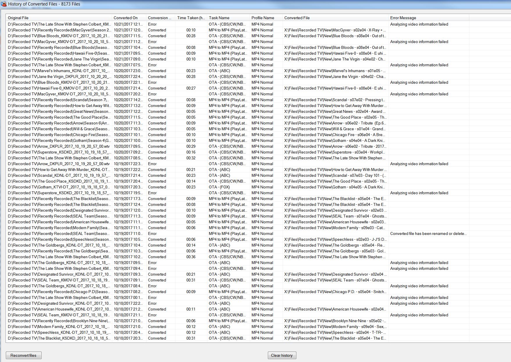

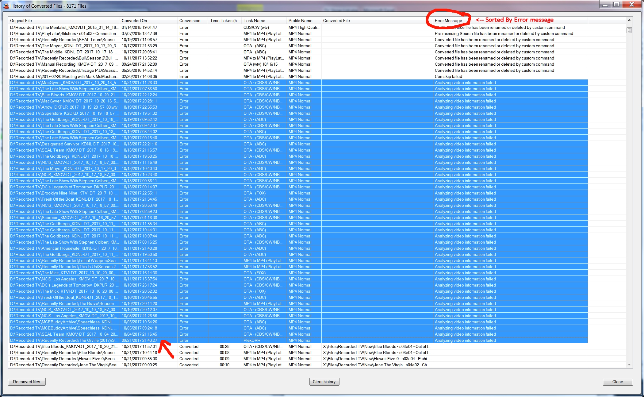

I went to the ‘History of Converted Files’ and Sorted on the error message column. The first time I saw the “Analyzing video information failed” error listed was on 9/21/2017, since then I have seen the error 43 times.
When I see the files have not converted I manually add them to the MCEBuddy queue and try again. Sometimes they convert just fine but other times it errors again. I may have to do this multiple times before it actually works. There does not seem to be any rhyme or reason to why it works or does not work.
