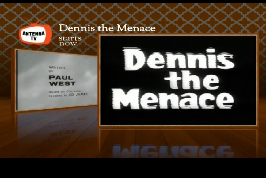

I’ve noticed the dual episode screen endings on some stations are being marked as commercials. Can anyone help me prevent this?
I have a test video at https://chambers.pw/test-video/test.ts around 3 mb
