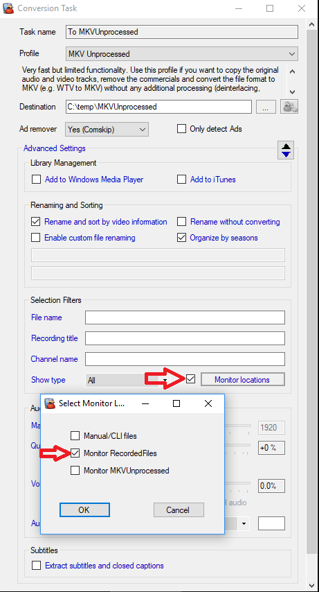

Step 2: Setup a Conversion Task which converts your TS file to MKVUnprocessed files. Set the destination to c:\tempMKVUnprocessed. You will want to remove commercials on this one (so it's set to Comskip or whatever you use). Also don't forget to select theMonitor locations` box and select your the Monitor Location you created in Step 1:

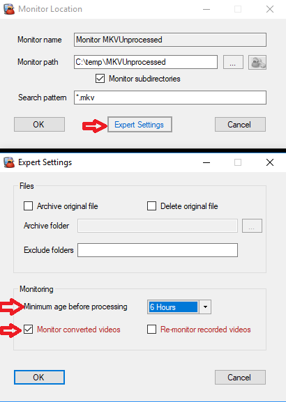

Step 3: Setup a second Monitor Location which monitors the output of your first Conversion task c:\temp\MKVUnprocessed. Also open the Expert Settings page on your Monitor Location and set the time delay, Minimum age before processing, to whatever you want (e.g. you want a 6 or 12 hour delay before the MKV’s are converted). Also don’t forget to check the Monitor converted videos. This is important since by default MCEBuddy won’t reconvert already converted files, this is to tell MCEBuddy that you specifically want to reconvert the already converted file.

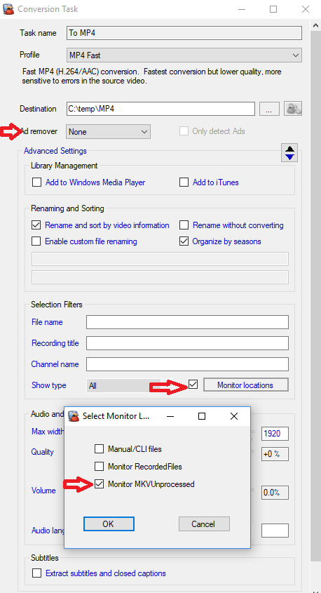

Step 4: Now create a second conversion task which will convert your MKV to MP4. This time you need to select the Monitor location that was created in Step 3. You also don’t want to run ad detection again since it was already done in Step 2, so set it to None.
