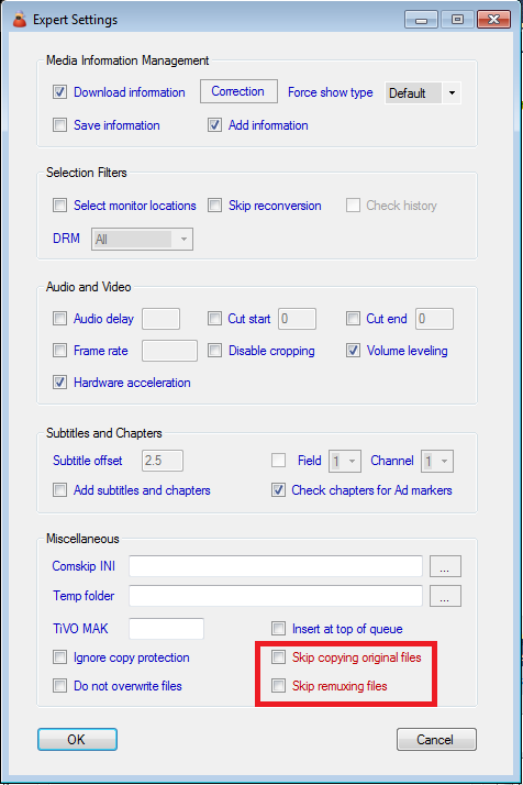

I’m going to take a guess here and say that you’ve enabled one of these options:
Either Skip copying original files or Skip remuxing files
If so you need to ensure that NEITHER of these options are checked, that’s probably why it’s failing because when you don’t copy the "%sourcefile% is the same as the %originalfilepath%\%originalfilename%.%originalext% which is what PartCopy is complaining about, source and destination are the same. If you check one of these options you will end up with this problem. Uncheck these options and it’ll work.

I checked. The two skipped boxes are unchecked.

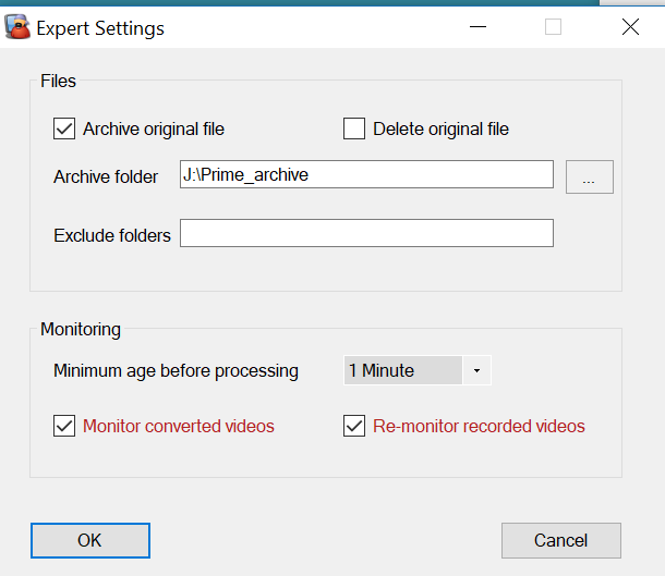

I do have the following in my Monitor Location Expert settings
archive original file checked
Delete Original File unchecked,
archive folder designated.
Exclude folder blank
Minimum age before processing 1 minute.
Monitor converted videos checked
remonitor recorded videos checked.
Could any of this cause the issue?

Unlikely. Can you attach your conversion log.
