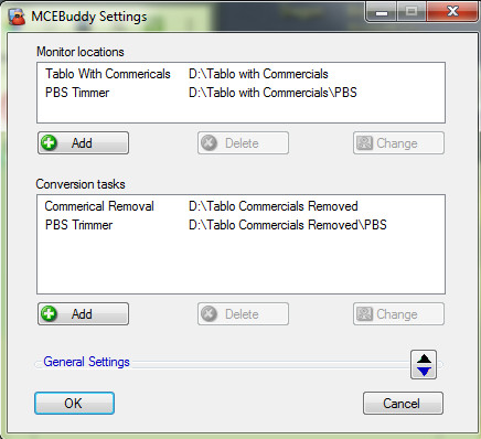

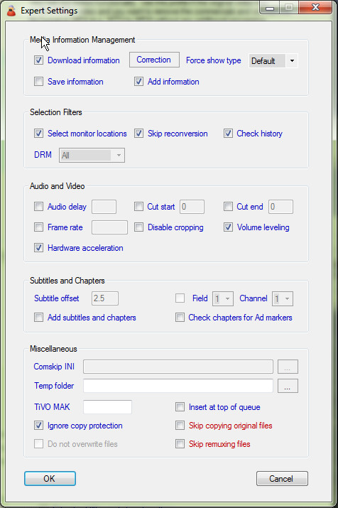

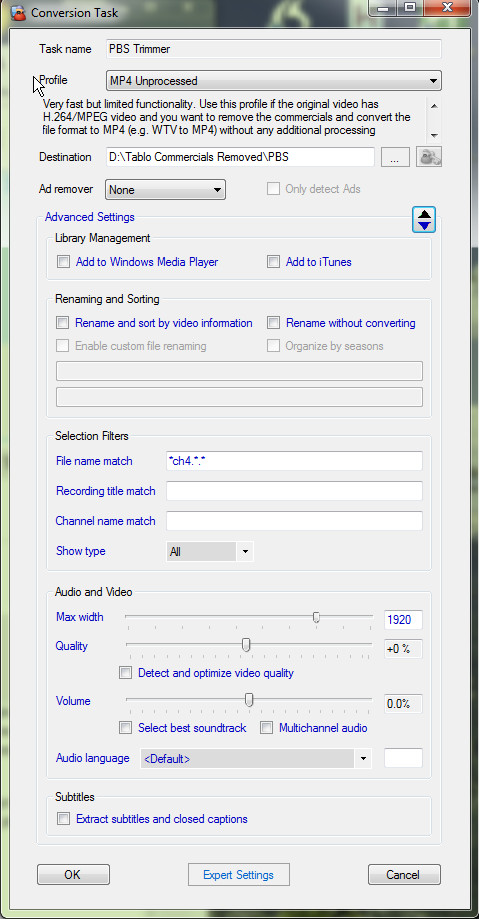

I am including images of my configuration and two log files created in the Debug mode.

Yes, I agree using the MP4 Normal profile the audio is in sync. So the problem is with the MP4 Unprocessed profile.
I love your enthusiasm but America’s Test Kitchen is a PBS show and does not have any commercials in it. So I use the MP4 Unprocessed profile with no Ad remover to save time on the conversion of all PBS shows.
I just downloaded and installed 2.4.8 Beta because the date on the directory had changed….it appears that the files in the zip file did not change, but I installed it anyway.
Using the MP4 Unprocessed profile, trimming 60 seconds from the beginning and end, there is a very noticeable audio sync delay.
