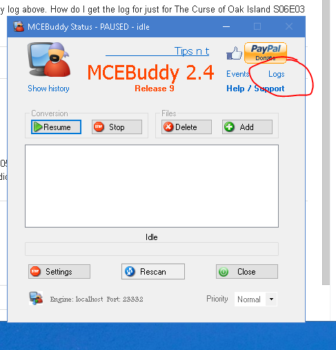

correct, it did not cut the commercial. I uploaded mcebuddy log above. How do I get the log for just for The Curse of Oak Island S06E03 20181127 [20181128-0533].mpg?

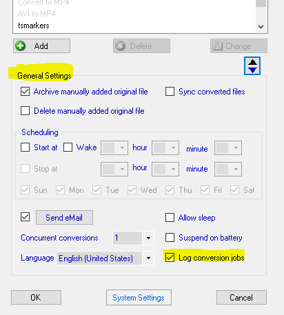

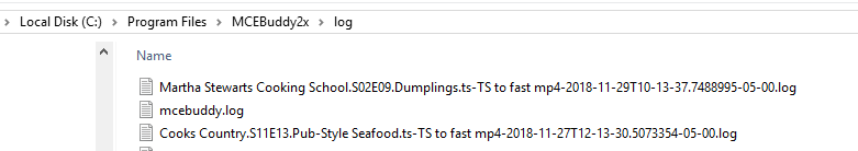

Click the logs button on MCEBuddy and it will open the folder to C:\Program Files\MCEBuddy2x\log. It should be in there. You should have “log conversion jobs” ticked under general settings, too, for them to be logged. Let’s hope you do. Those logs give the play by play action of the actual conversion.
