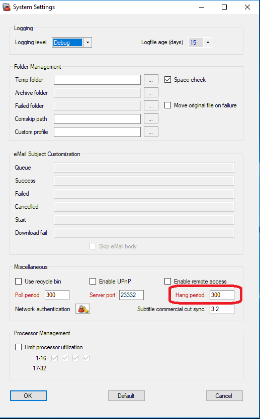

Thanks for that information, we’ll edit the default log level for comskip in the next build.
Meanwhile you can adjust the hang detection timeout from the System Settings page:
